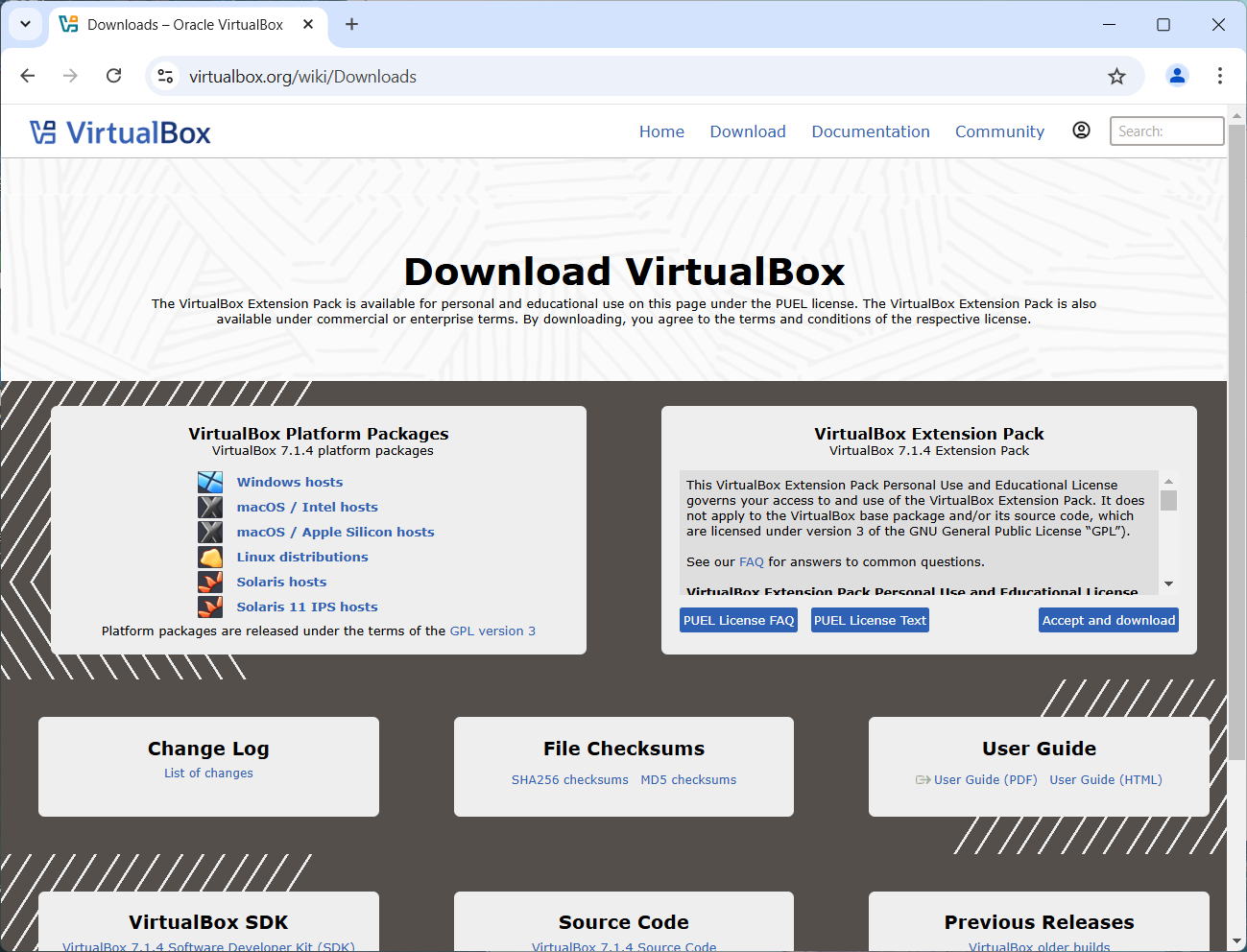

Download and install a virtual machine manager, with [VirtualBox](https://www.virtualbox.org/wiki/Downloads) being recommended.

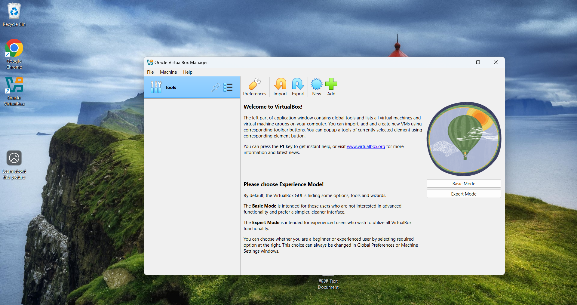

Launch VirtualBox

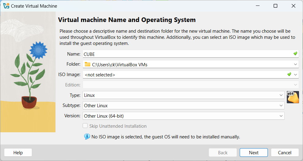

Name the virtual machine, select “Linux” as the type, “Other Linux” as the subtype, and “Other Linux (64 bit)” as the version.

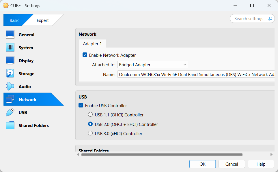

Under the “Network” tab, configure the network connection as “Bridged Adapter” and select the network adapter you are using.

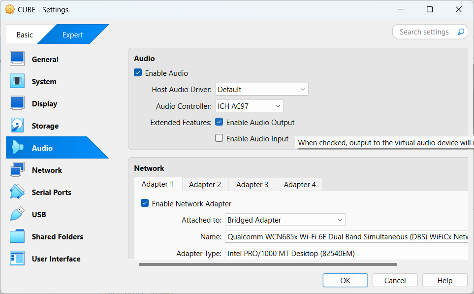

Under “Audio”, enable sound and choose the Default option as the controller.&#x20;
<img src="https://67406449-files.gitbook.io/~/files/v0/b/gitbook-x-prod.appspot.com/o/spaces%2FCnF8kmk9yw3yiy2mRerq%2Fuploads%2FMm18yjdoBCAdBrW9LfPG%2FScreenshot%202024-11-18%20151206.png?alt=media&amp;token=7c32ee24-cf6c-4d5f-9275-65a0e3665c37" alt="" data-size="original">
**Optional:** For Zigbee Dongle usage, insert the Zigbee Dongle at this step and select the correct controller type under “USB”. In the USB filter, add the necessary Zigbee Dongle using the add button on the side.

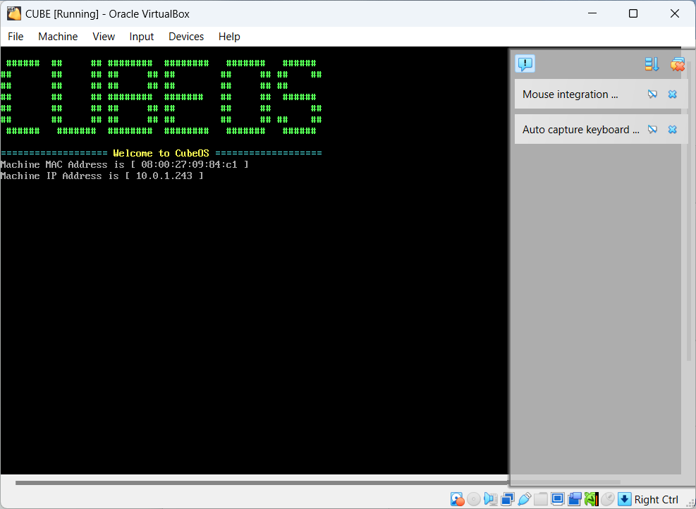

Monitor the boot screen until the boot is complete.
<img src="https://67406449-files.gitbook.io/~/files/v0/b/gitbook-x-prod.appspot.com/o/spaces%2FCnF8kmk9yw3yiy2mRerq%2Fuploads%2FQwVa8ZvQR1dReJTIzIsb%2FScreenshot%202024-11-18%20152604.png?alt=media&amp;token=439aa522-de74-4147-84a7-6c02c0fac499" alt="" data-size="original">
Once completed, you will see the CUBE OS' IP displayed on the screen. Use this IP address or [cube.local](http://cube.local) to access the CUBE OS Web management page.
