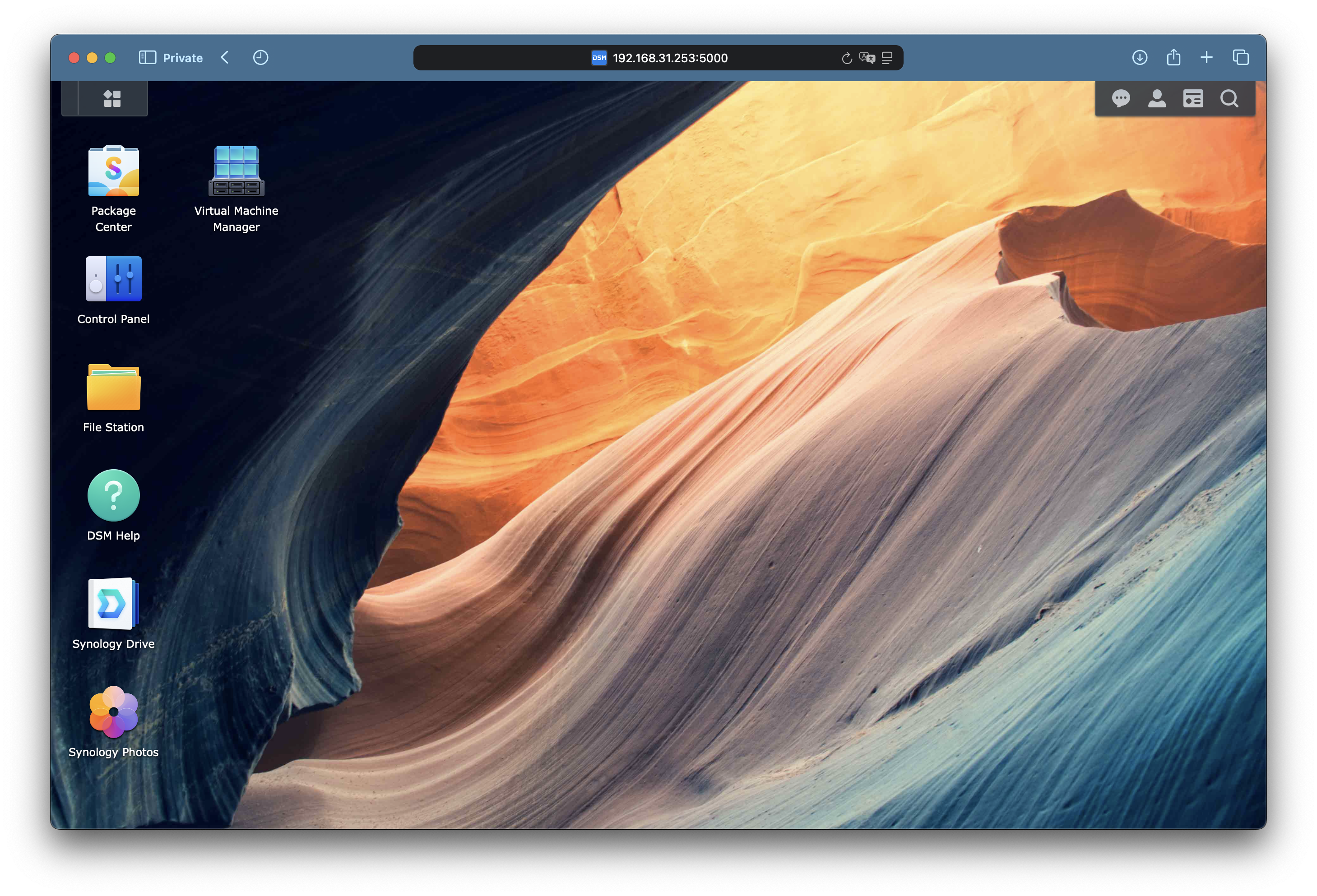

&#x20;Access to Synology dashboard
<img src="https://67406449-files.gitbook.io/~/files/v0/b/gitbook-x-prod.appspot.com/o/spaces%2FCnF8kmk9yw3yiy2mRerq%2Fuploads%2FCa0IDeHzIjTA8Rd9oO6h%2FScreenshot%202024-11-18%20at%2018.32.02.png?alt=media&amp;token=b32de532-00c1-489d-a8ff-850048597771" alt="" data-size="original">

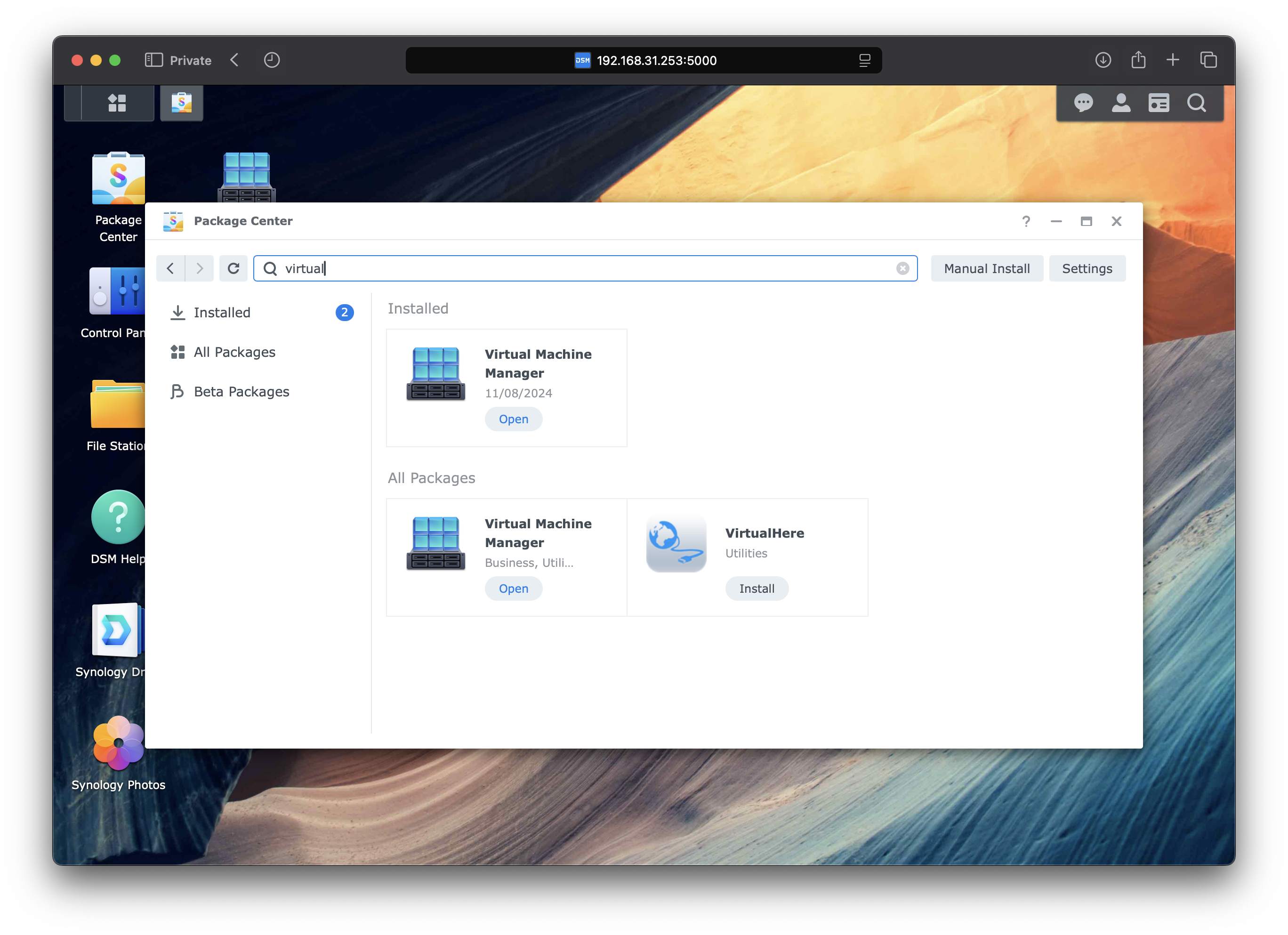

Install `Virtual Machine Manager` from the Package Center

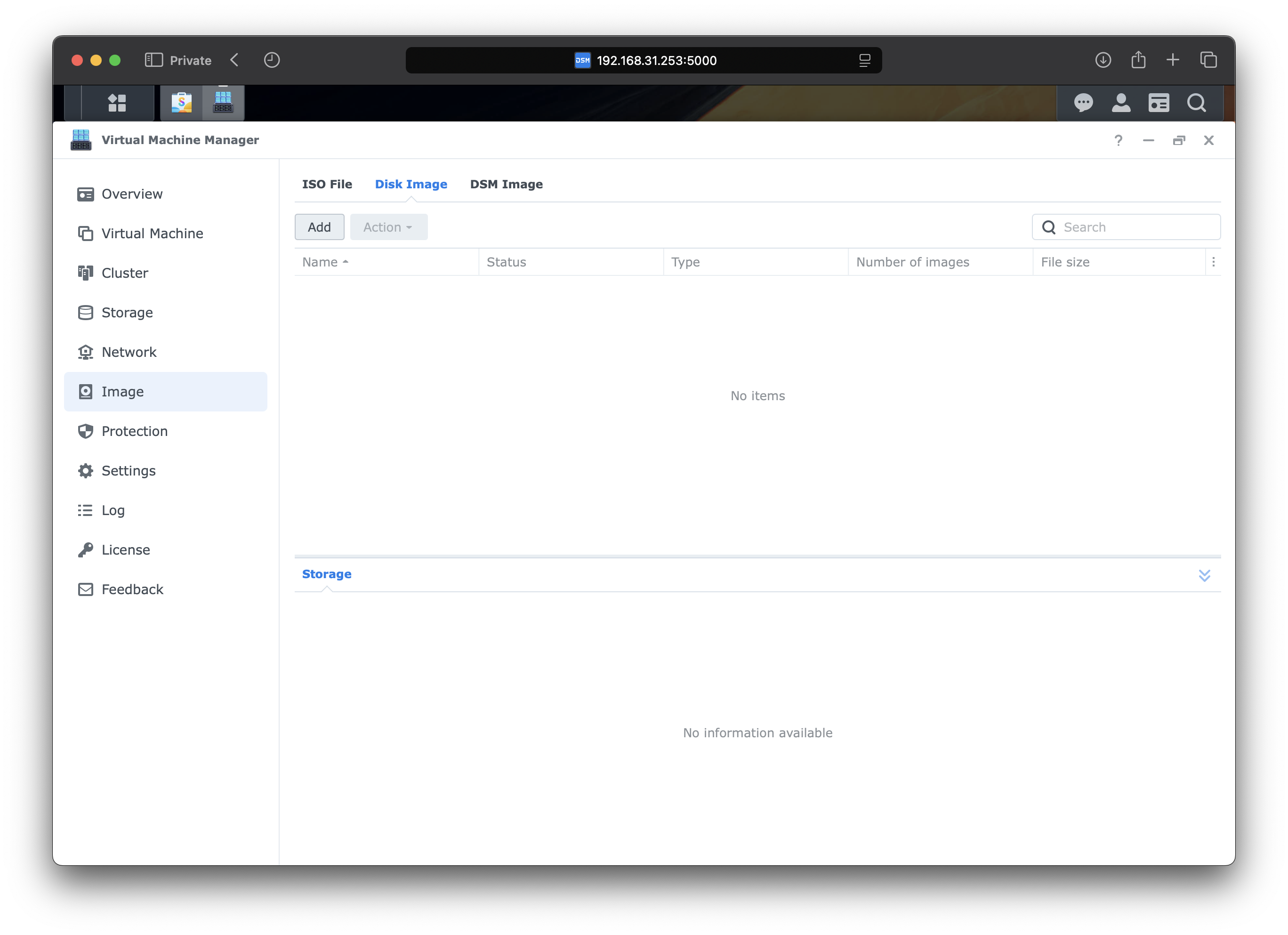

Launch `Virtual Machine Manager` from the dashboard and switch to the Image page.

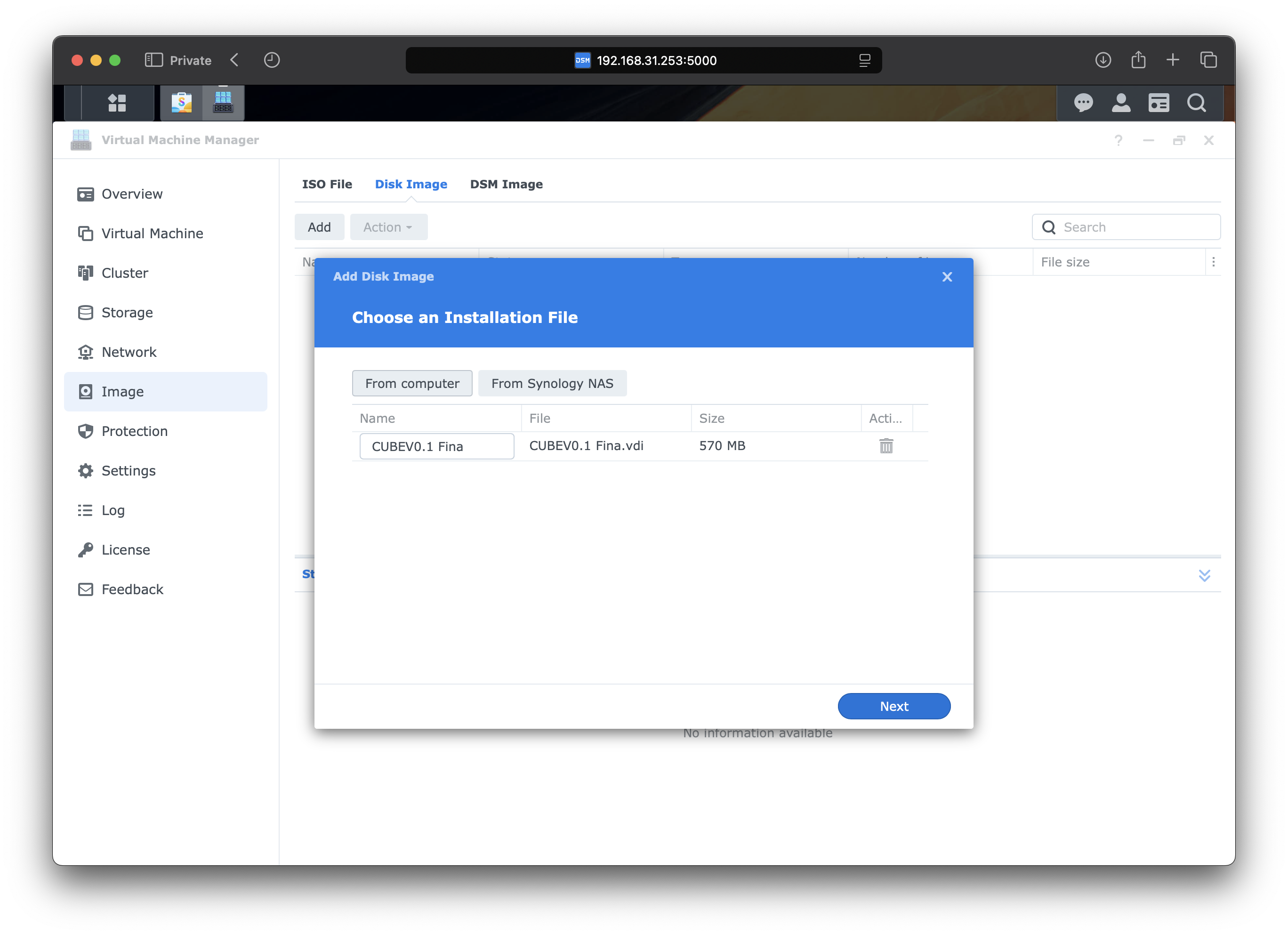

Enter the Disk Image tab, then click the `Add` button.
<img src="https://67406449-files.gitbook.io/~/files/v0/b/gitbook-x-prod.appspot.com/o/spaces%2FCnF8kmk9yw3yiy2mRerq%2Fuploads%2Ffa4JCGio2dc60vxHK9hC%2FScreenshot%202024-11-18%20at%2016.03.24.png?alt=media&amp;token=0d58f0cc-77ad-4cca-9577-3e3401bcc7da" alt="" data-size="original">
Follow the guide to upload the `.vdi` file you downloaded from the previous [step](#preparation).

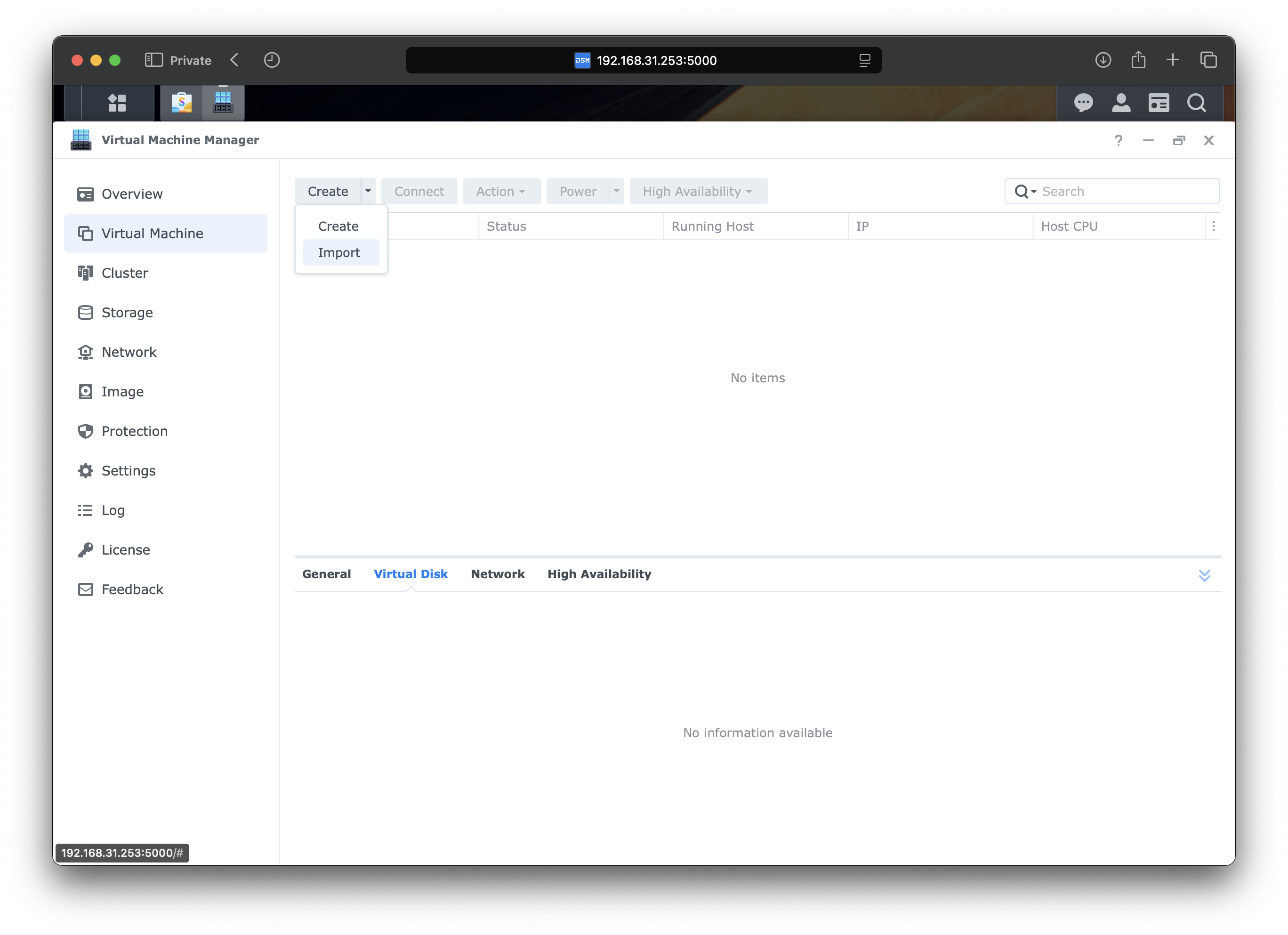

Switch to the `Virtual Machine` page and click on the dropdown icon next to the `Create` button and use `Import`.&#x20;
<img src="https://67406449-files.gitbook.io/~/files/v0/b/gitbook-x-prod.appspot.com/o/spaces%2FCnF8kmk9yw3yiy2mRerq%2Fuploads%2FFJasCUhq06WNcc6QtGz7%2FScreenshot%202024-11-18%20at%2016.25.37.png?alt=media&amp;token=7641c364-a15d-4989-bbe7-51c4bb8e2f01" alt="" data-size="original">

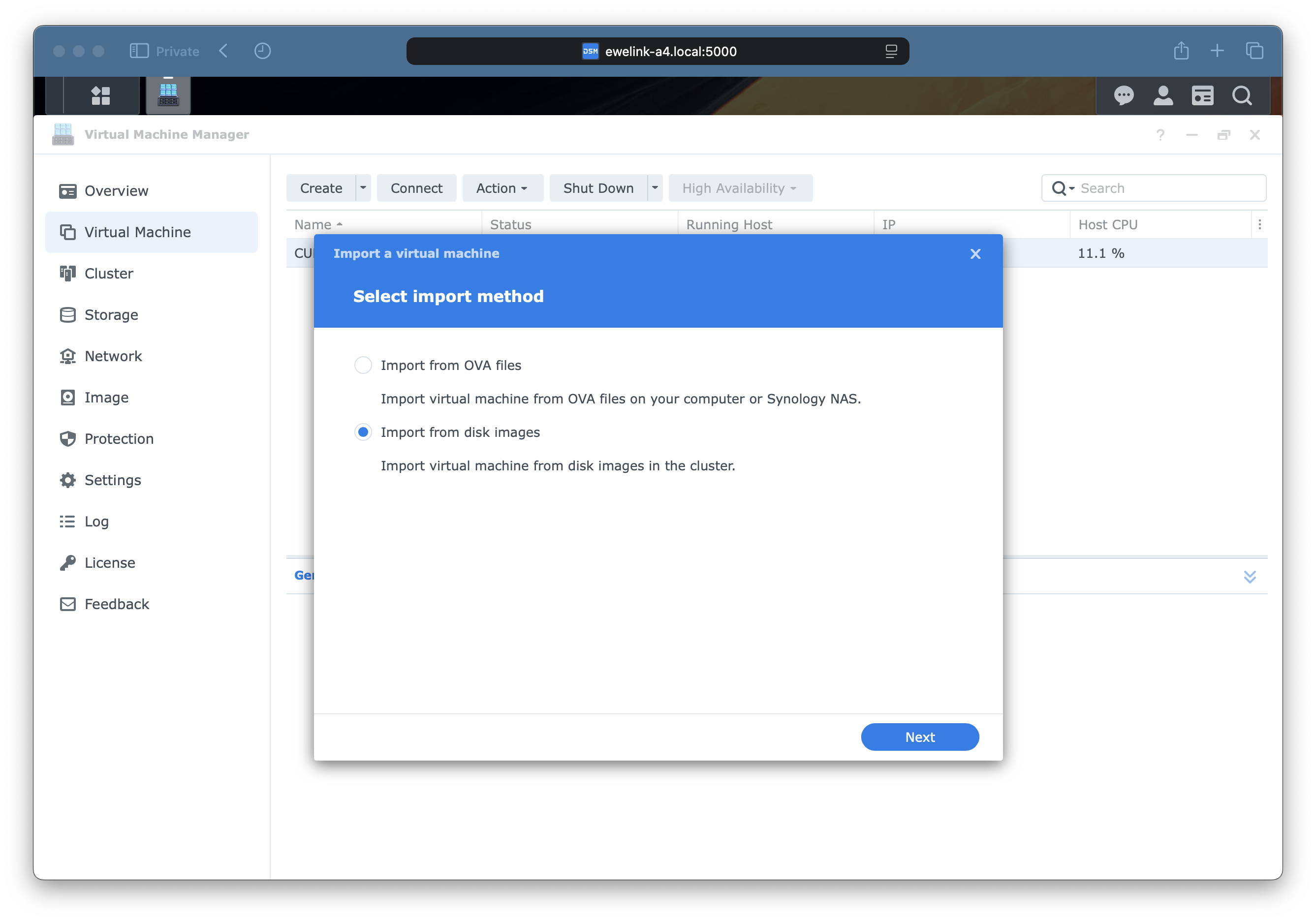

Select the `Import from disk images` option on the wizard.
<img src="https://67406449-files.gitbook.io/~/files/v0/b/gitbook-x-prod.appspot.com/o/spaces%2FCnF8kmk9yw3yiy2mRerq%2Fuploads%2FG425fdrrBq0WzAaomcEY%2FScreenshot%202024-11-27%20at%2015.01.10.png?alt=media&amp;token=cb71379b-c00b-40c2-9cd1-28ced24a50f6" alt="" data-size="original">

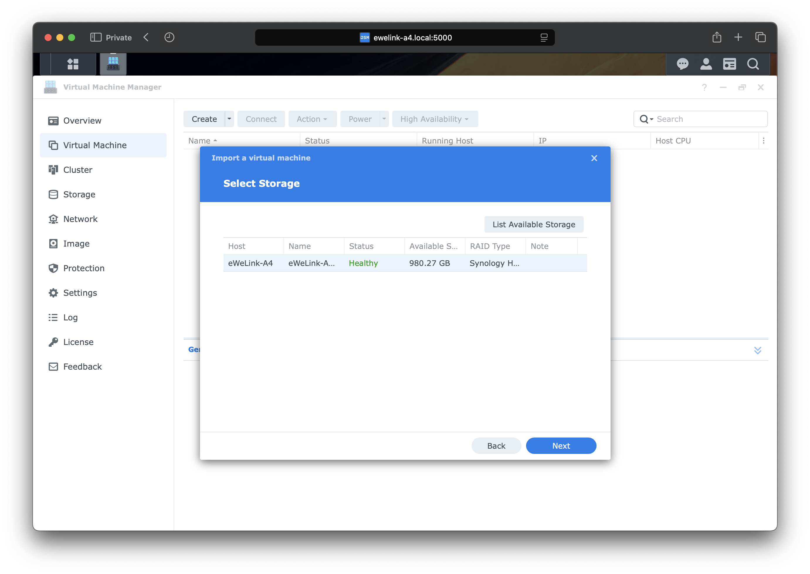

Select the storage where you uploaded the virtual disk file.
<img src="https://67406449-files.gitbook.io/~/files/v0/b/gitbook-x-prod.appspot.com/o/spaces%2FCnF8kmk9yw3yiy2mRerq%2Fuploads%2FMxh732JOfTy0hO65gty6%2FScreenshot%202024-11-27%20at%2015.59.43.png?alt=media&amp;token=293a0c5b-b690-463b-9494-7632a6a31d13" alt="" data-size="original">

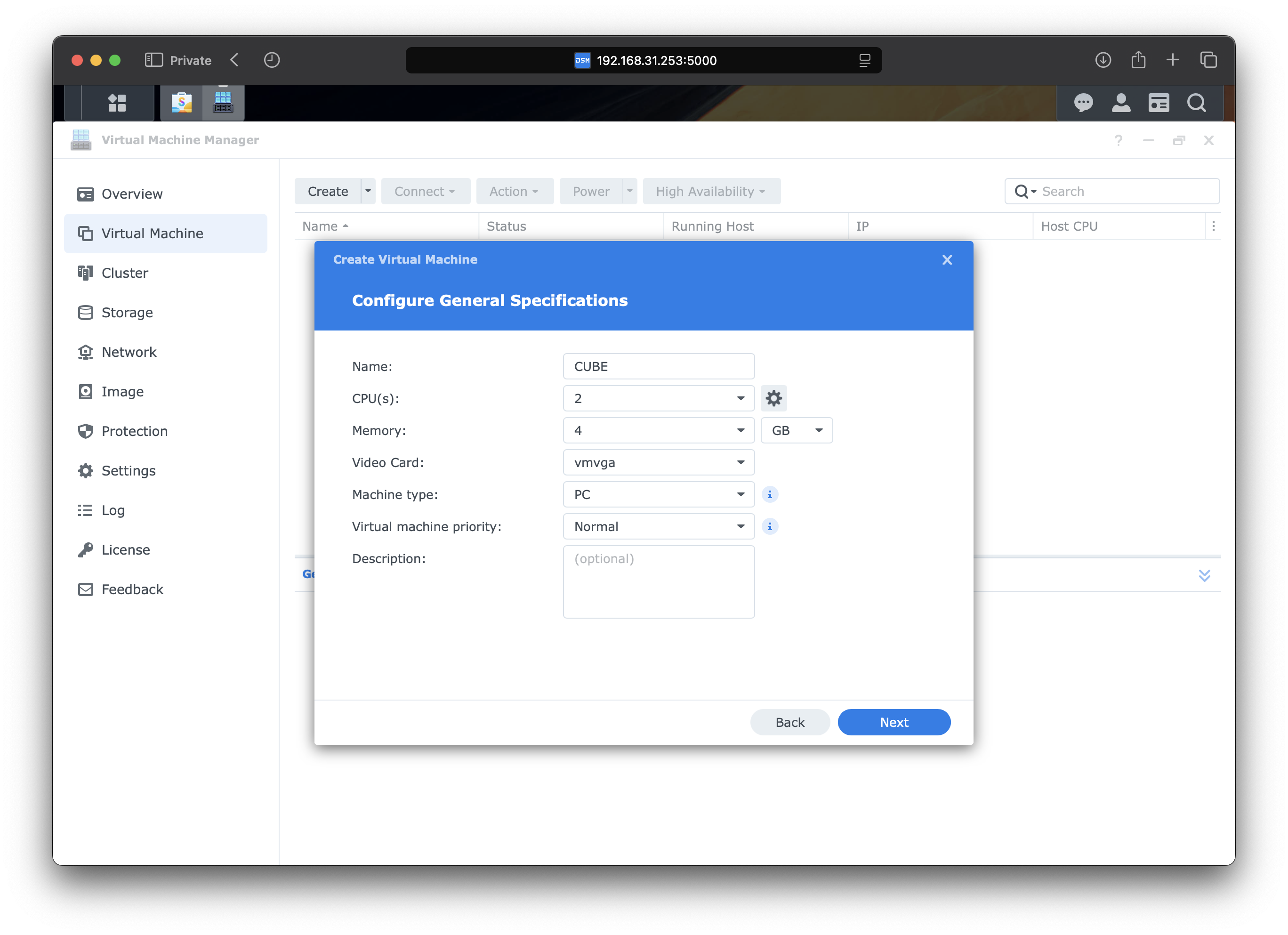

Set the computational resources CUBE OS needs.
**2 vCPUs and 4GB RAM are recommended for a better experience.**

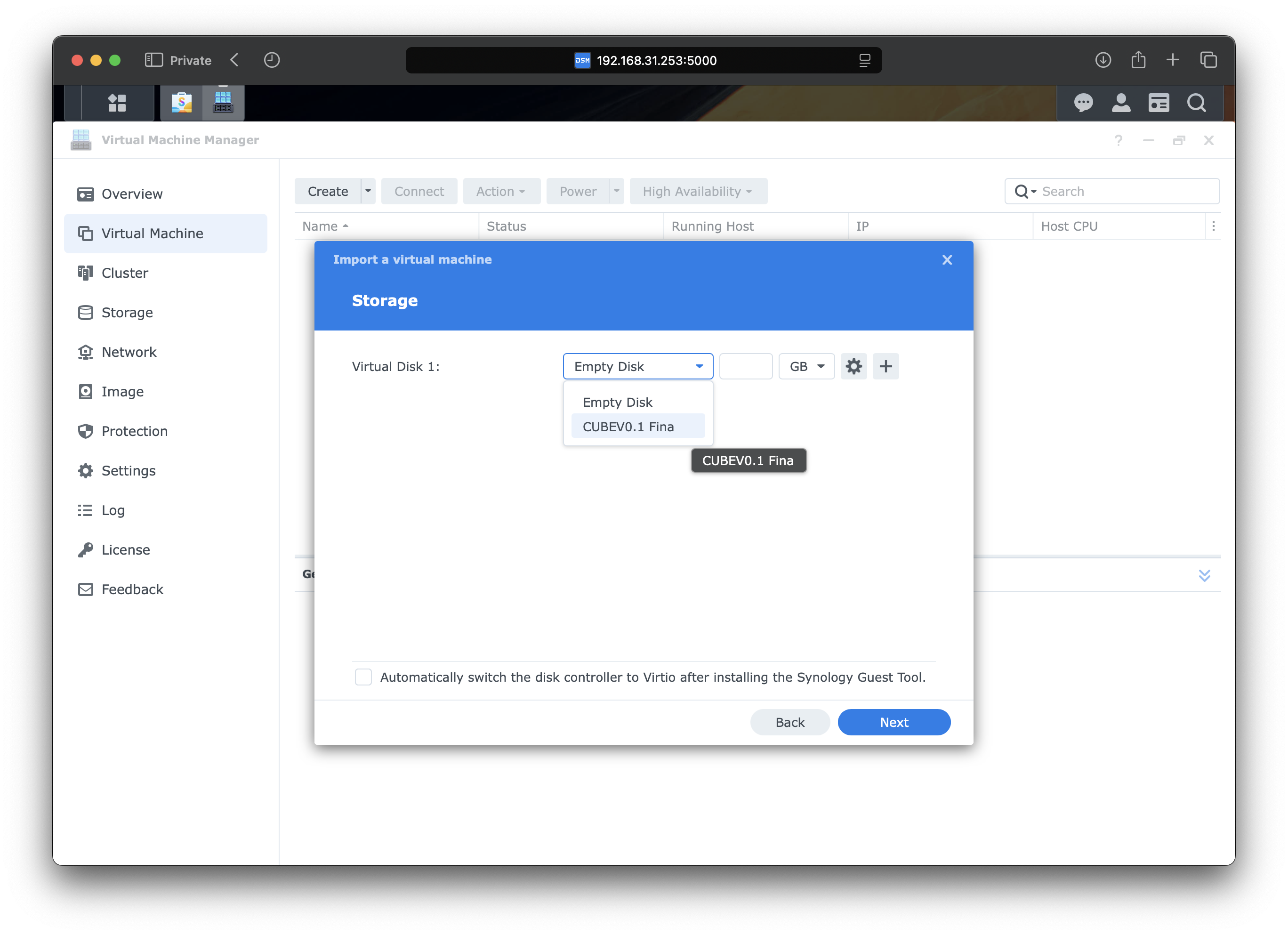

Choose the virtual disk on the dropdown list.
<img src="https://67406449-files.gitbook.io/~/files/v0/b/gitbook-x-prod.appspot.com/o/spaces%2FCnF8kmk9yw3yiy2mRerq%2Fuploads%2FNA2BMI9IWtylpKbLOeFg%2FScreenshot%202024-11-18%20at%2016.26.07.png?alt=media&amp;token=c78da8b9-93d7-4010-a5c3-99abfa76847a" alt="" data-size="original">

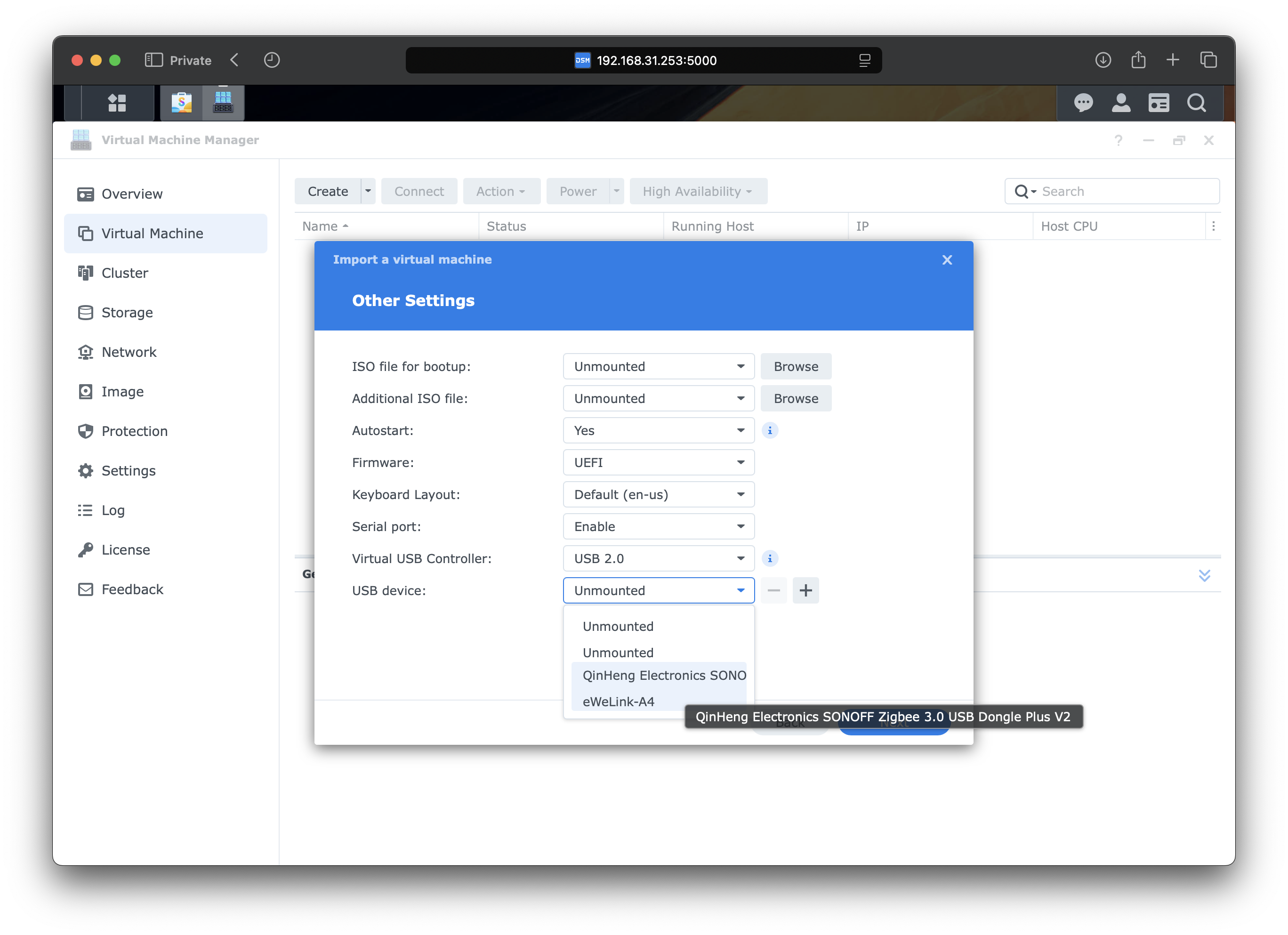

Optional: Plug in your Zigbee dongle to your NAS, and pass through the device to the virtual machine on this page.
For more information on Zigbee configurations and compatibility, please refer to this [guide](https://cube.ewelink.cc/compatibility-check/zigbee.md).

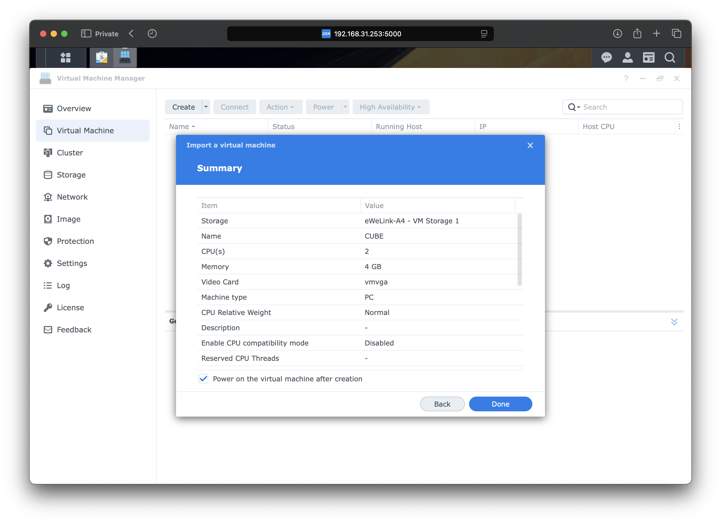

Final review of your configuration, check `Power on the virtual machine after creation` and click `Done`
<img src="https://67406449-files.gitbook.io/~/files/v0/b/gitbook-x-prod.appspot.com/o/spaces%2FCnF8kmk9yw3yiy2mRerq%2Fuploads%2FsOxapXaxEBj1cOf2EaP5%2FScreenshot%202024-11-18%20at%2016.26.51.png?alt=media&amp;token=e0151607-b55d-4db3-a571-0747c702e04f" alt="" data-size="original">

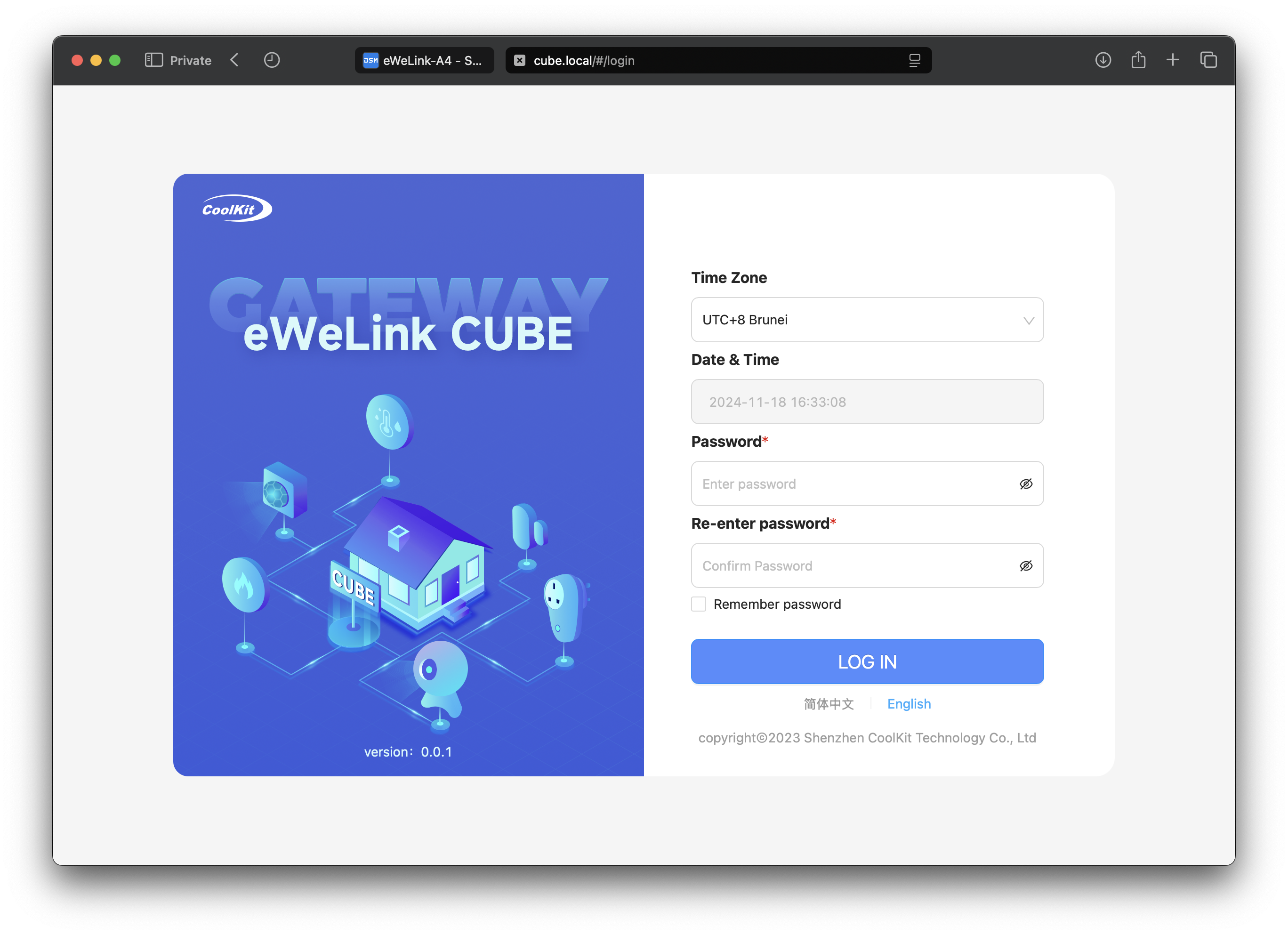

Wait for a few minutes. Enter [cube.local](http://cube.local) on your browser to access the onboarding page.
You can also access it via IP alternatively.
<img src="https://67406449-files.gitbook.io/~/files/v0/b/gitbook-x-prod.appspot.com/o/spaces%2FCnF8kmk9yw3yiy2mRerq%2Fuploads%2F8L0fPypCix5FIElQ64lt%2FScreenshot%202024-11-18%20at%2016.33.08.png?alt=media&amp;token=951e09b3-3e19-436d-b5a3-74bd60a5d5d1" alt="" data-size="original">
Upon successful access, a short ID can be viewed on the settings page. Subsequently, access the CUBE OS Web management page using cube-{short id}.local, which is useful for differentiating multiple CUBE OS instances on the same local network.
