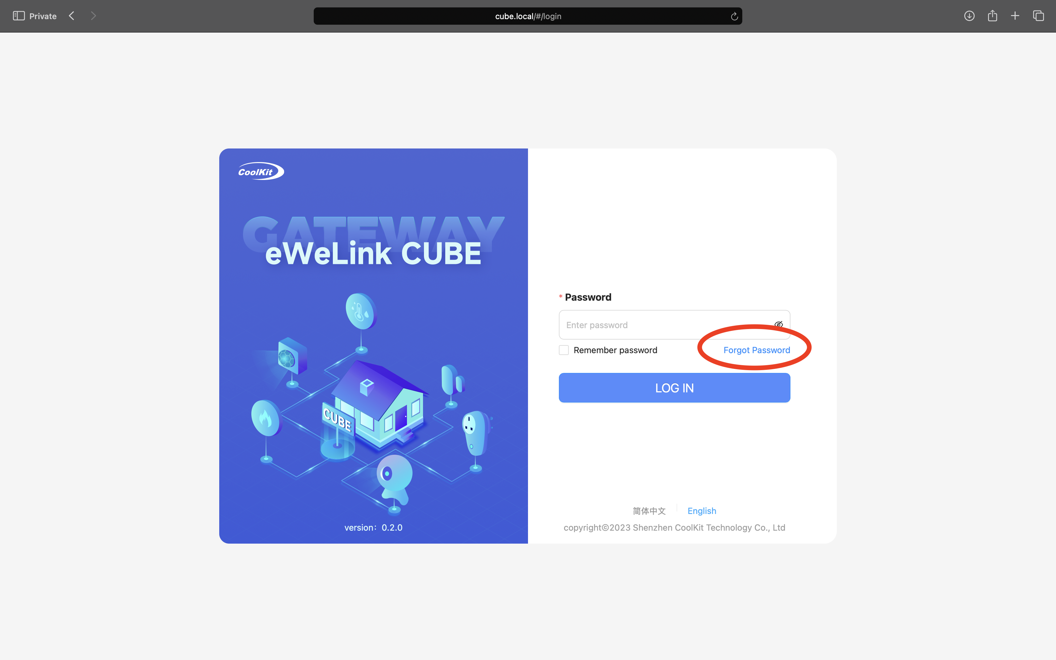

Nella pagina di accesso, fai clic su `Password dimenticata`.
<figure><img src="https://2847557189-files.gitbook.io/~/files/v0/b/gitbook-x-prod.appspot.com/o/spaces%2FCnF8kmk9yw3yiy2mRerq%2Fuploads%2F8IEv3ebK06gyl76BUdQA%2FScreenshot%202025-01-03%20at%2015.06.57.png?alt=media&amp;token=a20db2c7-5433-40f0-9de3-eaf61506bd92" alt=""><figcaption></figcaption></figure>
